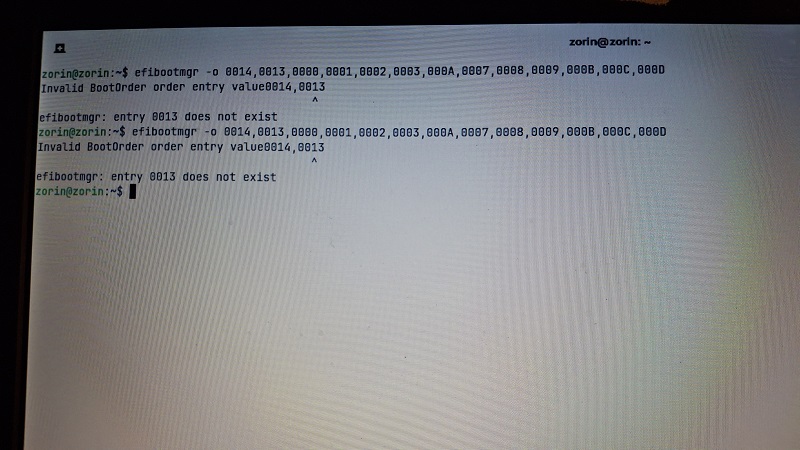

Merci beaucoup de m'aider Désolé mais je n'étais pas chez moi ces  jours Je viens de rentrer.
Voici les 2 commandes demandées :

zorin@zorin:~$ efibootmgr
BootCurrent: 000C
Timeout: 2 seconds
BootOrder: 0013,0000,0001,0002,0003,000A,0007,0008,0009,000B,000C,000D
Boot0000  Setup	FvFile(721c8b66-426c-4e86-8e99-3457c46ab0b9)
Boot0001  Boot Menu	FvFile(126a762d-5758-4fca-8531-201a7f57f850)
Boot0002  Diagnostic Splash Screen	FvFile(a7d8d9a6-6ab0-4aeb-ad9d-163e59a7a380)
Boot0003  Lenovo Diagnostics	FvFile(3f7e615b-0d45-4f80-88dc-26b234958560)
Boot0004  Startup Interrupt Menu	FvFile(f46ee6f4-4785-43a3-923d-7f786c3c8479)
Boot0005  Rescue and Recovery	FvFile(665d3f60-ad3e-4cad-8e26-db46eee9f1b5)
Boot0006  MEBx Hot Key	FvFile(ac6fd56a-3d41-4efd-a1b9-870293811a28)
Boot0007* USB CD	VenMsg(bc7838d2-0f82-4d60-8316-c068ee79d25b,86701296aa5a7848b66cd49dd3ba6a55)
Boot0008* USB FDD	VenMsg(bc7838d2-0f82-4d60-8316-c068ee79d25b,6ff015a28830b543a8b8641009461e49)
Boot0009* ATAPI CD0	VenMsg(bc7838d2-0f82-4d60-8316-c068ee79d25b,aea2090adfde214e8b3a5e471856a35400)
Boot000A* ATA HDD0	VenMsg(bc7838d2-0f82-4d60-8316-c068ee79d25b,91af625956449f41a7b91f4f892ab0f604)
Boot000B* ATA HDD1	VenMsg(bc7838d2-0f82-4d60-8316-c068ee79d25b,91af625956449f41a7b91f4f892ab0f605)
Boot000C* USB HDD	VenMsg(bc7838d2-0f82-4d60-8316-c068ee79d25b,33e821aaaf33bc4789bd419f88c50803)
Boot000D* PCI LAN	VenMsg(bc7838d2-0f82-4d60-8316-c068ee79d25b,78a84aaf2b2afc4ea79cf5cc8f3d3803)
Boot000E* IDER BOOT CDROM	PciRoot(0x0)/Pci(0x16,0x2)/Ata(0,1,0)
Boot000F* IDER BOOT Floppy	PciRoot(0x0)/Pci(0x16,0x2)/Ata(0,0,0)
Boot0010* ATA HDD	VenMsg(bc7838d2-0f82-4d60-8316-c068ee79d25b,91af625956449f41a7b91f4f892ab0f6)
Boot0011* ATAPI CD	VenMsg(bc7838d2-0f82-4d60-8316-c068ee79d25b,aea2090adfde214e8b3a5e471856a354)
Boot0012* PCI LAN	VenMsg(bc7838d2-0f82-4d60-8316-c068ee79d25b,78a84aaf2b2afc4ea79cf5cc8f3d3803)
Boot0013* Windows Boot Manager	HD(1,GPT,cdb7ce3c-3762-4291-a7e4-1920b283bc1a,0x800,0x32000)/File(\EFI\Microsoft\Boot\bootmgfw.efi)57494e444f5753000100000088000000780000004200430044004f0042004a004500430054003d007b00390064006500610038003600320063002d0035006300640064002d0034006500370030002d0061006300630031002d006600330032006200330034003400640034003700390035007d00000061000100000010000000040000007fff0400
Boot0014* Zorin OS	HD(1,GPT,9e070e54-2296-4475-aa84-2c58621a4def,0x800,0x66668)/File(\EFI\ubuntu\shimx64.efi)
zorin@zorin:~$

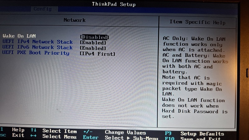

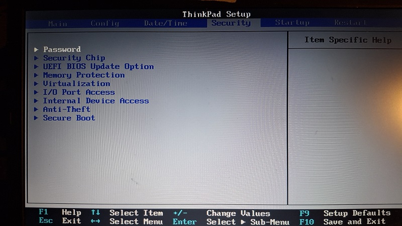

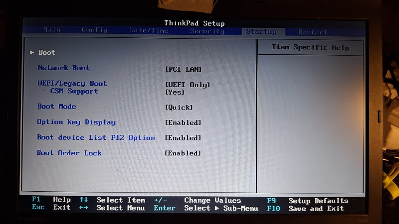

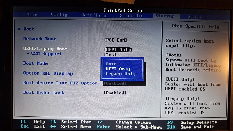

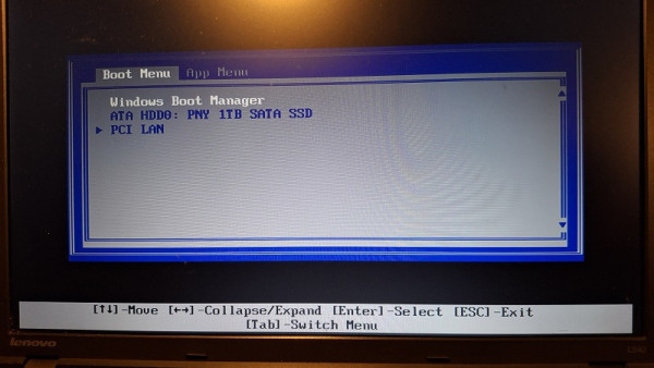

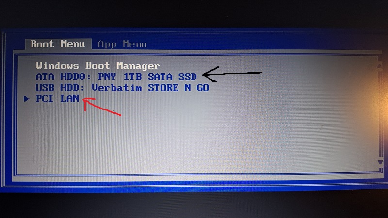

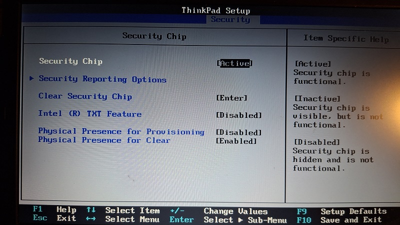

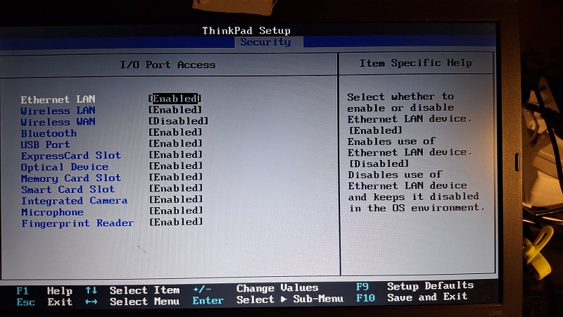

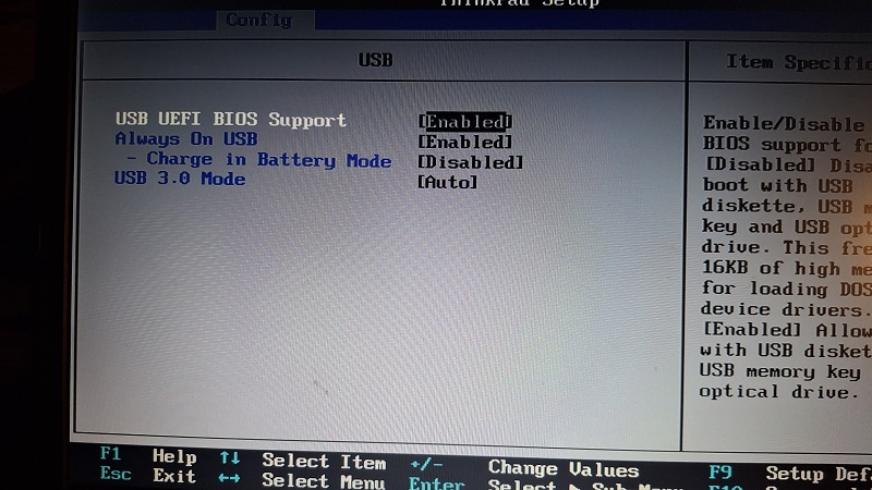

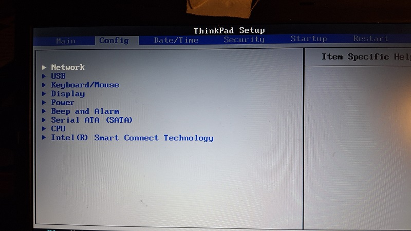

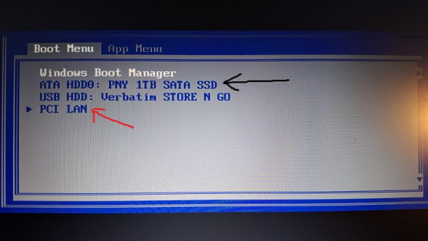

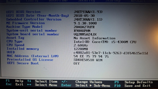

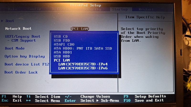

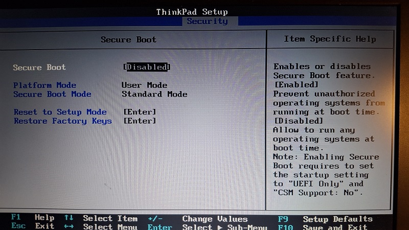

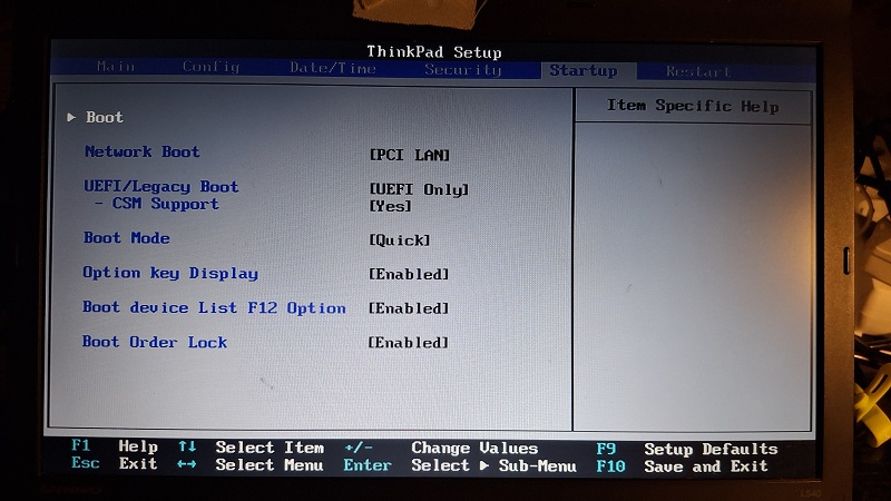

quand je fais F12, j'ai ça comme choix de boot :
et dans le bios (F1), j'ai ça :
Mais rien en lien avec Zorin
Par contre pour l'ordre du boot, j'aimerai avoir dans l'odre :
-win 10
-win 7
-zorin

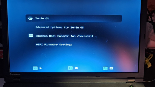

Merci pour les photos, @tolunq !
Elles confirment ce que le terminal renvoyait : le micrologiciel UEFI est essentiellement occupé par des entrées matérielles et réseau et Zorin n'y figure pas pour la raison que je t'ai expliquée ci-dessus.
tolunq a écrit : lun. 29 déc. 2025 21:51 Par contre pour l'ordre du boot, j'aimerai avoir dans l'odre :
-win 10
-win 7
-zorin
C'est logiquement Windows Boot Manager qui assure le démarrage du système. Comme d'autres produits maison, cette application "Windows-centrée" n'est pas prévue pour accueillir (facilement ?) d'autres OS, ce qui explique que Zorin en soit exclu — j'ai vécu cette situation sur mes deux derniers ordinateurs UEFI sur lesquels Windows était déjà installé.
En revanche, les distributions Linux (comme Zorin) possèdent leur propre gestionnaire de démarrage (GRUB) qui intègre les OS disponibles (dont Windows) dans un même menu : mettre Zorin en tête de la séquence est un des moyens de faire en sorte que ce soit ce menu qui s'affiche au démarrage.
Ensuite, on peut ordonner les entrées dudit menu comme on le souhaite — ma photo est mauvaise et elle date un peu, mais c'est pour te donner une idée du menu de démarrage de Zorin dans le cadre d'un multi-boot Linux/Windows :

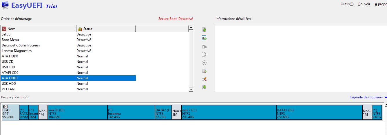

Lis le message que j'ai posté lorsque j'ai résolu le problème pour la première fois.

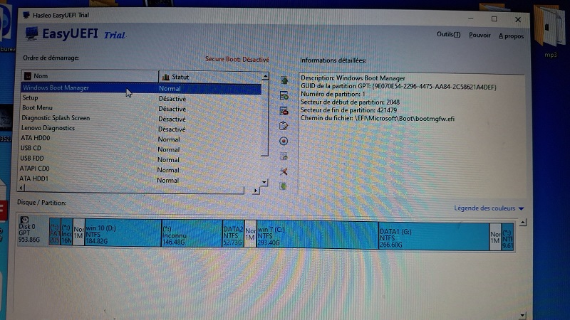

Démarre sur Windows, télécharge la version d'essai d'EasyUEFI — que ça marche ou non, tu n'auras pas à t'en resservir — et désactive Microsoft Boot Manager en suivant les instructions de ma copie d'écran ou les explications du site.
Si ça ne marche pas, on essaiera autre chose. 😅

je n'ai pas la possibilité de le faire avec easy uefi...
je n'ai pas de ligne windows boot manager et le bouton où il faut appuyer est désactivée pour toutes lignes présentes

Inspecte d'abord le BIOS en détail ("F1") pour voir s'il n'y a pas un paramètre qui bloquerait les modifications.
Si oui, désactive-le, enregistre la modification (regarde les indications), redémarre sur Windows et essaie à nouveau avec EasyUEFI.
Sinon, on passe au plan B, tant que la version d'essai d'EasyUEFI est valable.
Il s'agit d'intégrer l'entrée Zorin "0014" au "BootOrder" et de la placer en tête de liste sans rien modifier d'autre.
Démarre sur la clé d'installation de Zorin et choisis "Essayer Zorin" pour ouvrir une live session.
Lance le terminal ("Ctrl Alt t") et entre cette ligne (copier-coller) :
efibootmgr -o 0014,0013,0000,0001,0002,0003,000A,0007,0008,0009,000B,000C,000D
Redémarre.
Si rien n'a changé, redémarre sur Windows, lance EasyUEFI et vérifie si l'entrée Zorin ne figurerait pas dans la liste de boot.
Si jamais Microsoft Boot Manager est subitement apparu, ne te gène pas pour le désactiver d'abord, redémarrer et vérifier.
Si Zorin apparaît et que son entrée n'est pas en tête de liste, suis les explications données sur cette page pour l'y placer.

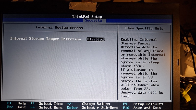

je n'ai rien trouvé de particulier dans le BIOS.
ci dessous des captures d'écran au cas où quelque chose cloche dans les réglages...
Je vais attendre ton analyse avant de me lancer dans l'entrée Zorin "0014" au "BootOrder"

Le lien vers le manuel n'apparaissait pas suffisamment dans mon message précédent, mais tous les paramètres du BIOS sont expliqués en français à partir de la page 95.
Et je pense qu'il faut le mode UEFI pour que ça fonctionne correctement.
N'oublie pas de vérifier si quelque chose change du côté d'EasyUEFI.

ok. on peut voir sur la photo précedent que le mode 'UEFI ONLY' est selectionné. Donc ce doit être bon.

Par contre 2 questions :

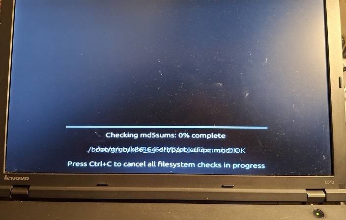

quand je démarre sur la clé usb ruffus pour "essayer" ou installer zorin, j'ai ça à chaque fois et impossbile de l'interrompre. c'est assez pénible à la longue :
lors de l'appui sur F12 pour le choix du boot, j'ai ça :
Flèche rouge c'est l'ordre du démarrage
Flèche noire c'est le ssd où il y a win 7, win 10 et zorin.
Qu'est ce que c'est que PCI Lan ?
Je n'ai rien trouvé de particulier Dans le BIOS, j'ai changé une ou 2 bricole mais rien qui touche au bios, secure ou UEFI

visiblement il y a une erreur :

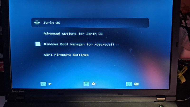

mais je vois que ça a marché quand même... le windows boot est apparu :)
tolunq
Messages : 42
Nb de « J’aime » reçus: 4
windos et zorin sur le même ssd. le multiboot ne fonctionne pas ???
Message par tolunq »
Cher jlb, je n'ai que 2 mots à vous dire ... "bravo et merci"
je n'y serais jamais arrivé sans les lignes de codes et ans le temps passé à me guider avec patience.
ça fonctionne bien.
Et j'ai ensuite essayer le boot windows et tout fonctionne aussi !
nickel !
Un très grand merci :)
